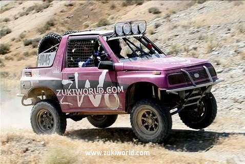

hey invincible, can i see a pic lf your door bars  for your cage. i am planning my cage and i will still use my car on the street.
Re: long travel struts
« Reply #26 on: September 02, 2011, 07:24:43 AM »

is that legal, i assume so. i was under the impression that the bars had to be up higher to provide side impast protection, anyways thats awesome. thank you for the pics
« Reply #29 on: September 06, 2011, 08:12:32 AM »
Yes, its legal.  door bars are a good idea, but not as necessary in desert racing as other forms of motorsports.
