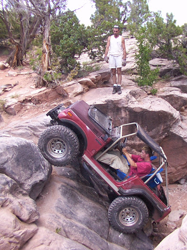

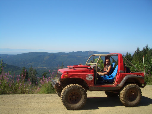

A good SPOA will give you room for 31" tires without having to do much else.  I was able to squeeze 33" tires on my SJ with a straight SPOA on the first version of it's build with rear fender trimming.  Personally I am not a fan of body lifts.  They don't look quite as nice, but I do recognize they have their place.
Original Build:
Current Build:
