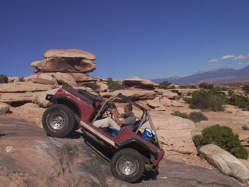

I love the way this Sami looks:
It's actually a little larger than I want to go with the tire and lift, but I would be happy with it I'm sure.  Idealy, 1" less on tire height and 1" less on the lift and it would be just about right for me.  My Sami is black too.
Re: Samurai suspensions? Any clear winner?
« Reply #6 on: September 05, 2012, 12:47:02 PM »
That is a SPOA with YJ springs and a missing link.

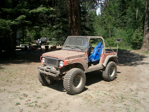

One issue with 33" tires is you are getting close to the breaking point.  I ran fine with my SJ-410 and 33's, but it really depends on your driving style.
SJ-410 with RUF (Rear Spring Up Front), 33x12.5" tires, SPOA with an additional main leaf to keep the springs at a slightly positive arch, front fender trimming:
Same SJ-410 with stock SPOA and rear fender cut out and some front fender hammer work done:
Samurai with Toyota width axles and 33x12.5" TSL's and YJ springs and Missing Link kit:
