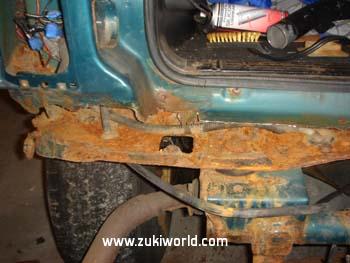

Well the nightmare started a little bit earlier, I was under the tracker (2dr - 1996), and found that my second to last cross member was gone, completely!  Which included my front gas tank mounts, and a few other items, so I figured, okay drop the tank, and weld in some new tubing. Well when I removed the bumper cover, I uncovered a plethora of rust.  Here are some pics and some questions I'd like to get your opinions on.

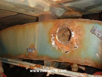

Here's the cross member cleaned up, still need to grind it down to get some clean metal to weld on.  Trying to decide if I should weld some small flat plates to the end of the new tube, and weld the plates to the frame, or try and drill out the existing holes, and run the tube all the way through the existing frame and re-weld the shock tower mounts to it?
Next is the rear of the body, most of which is rotted out, luckily below the tail lights, so the repairs shouldn't affect the appearance of the track kick.

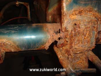

Rear Body Mount - The bottom plate that mounts to the frame still seems solid, it's really rusty, but maybe salvageable, won't know until I grind it down.
Rear Cross member -this should be an easy enough fix, going to cut out the existing tube and replace it with some straight tube.
Probably would be easier to find a doner tracker, but can't find anything under $800 in my area, I had some dom tubing around so no cost there, so my costs should just be from the sheet metal needed to repair the rear.  Was thinking about cutting it out clean and simply welding in some rectangle tube 2X4 or something like that.

What did you end up doing to reconnect the body to the frame, as you can see that area is pretty much shot.  What I found was really the only structural portion is the actual body mounts, there appears to be a reinforced 'L' bracket welded in place.  I plan to make my own 'L' brackets, for the body mounts, then sand/seal the what's left of the usable metal, and close it back in we sheet metal.  My sheet metal skills aren't so hot, so I'm not sure how's it's going to work out.
