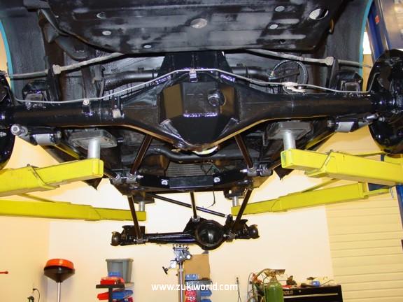

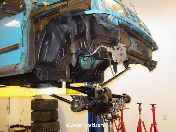

I'd love to seem some pics showing the link setup.
Re: ZUKIWORLD PROJECT: GODZUKI RESURRECTION - Comments and Suggestions thread.
« Reply #157 on: February 24, 2009, 02:42:31 PM »
I will try to find some for you. It may take a day or two (slammed at work getting a deadline out). If I have not posted by this weekend, PM me and remind me to.
LINKS!   ;)
I've re-read this, and maybe I missed it, but what's the diff gearing? And is that a 2.5 or 2.7L? Is the GRP Auto 4:1 tcase a Sidekick style case, or a Samurai case behind your trans? I'm tying to get 35/37" tires under a 2-door, and just trying to get ideas...
LINKS!   ;)
Hey, I knew I would forget (still working 7 days a week, damn high profiled build jobs, even the media is on this one  :P ) I'll try to get some up in a sec.
I'm running 5.37 gears in teh Toy axles, 2.5L GV motor and the 4:1 is an Australiam built Sidekick (Vitara for them) case gear set like the Trail Tough and Calmini gears. With the Auto, 5.37's and 4:1 it is geared just about perfect for my 37's.
Here is the only two pics I could find...
HTH,

It looks SO clean underneath!   /drool.....
Very very nice build!  Impressive.
Glad to hear someone's still working in this economy. Thanks for the info & pics. I may go the V6 route. Sounds better than making the 1.6L to work nice with 35/37" tires via a samurai t-case & tracker "doubler"... I'm going to be doing sand / desert stuff, so that extra power will come in handy.
