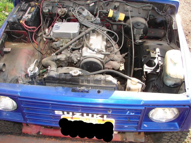

This is the Samurai I bought.  It is all stock except a webber carb.
After getting it home it appears the motor is junk. It seems to have a blown head gasket acording to my mechanic friend (water in the oil & oil in the radiator) + burns lots of oil so it wouldnt pass emitions here in ADA County. :rolleyes:  It also has a remote silinoid on the fire wall for some reason. & after being ran it wont start again for about an hr or so,  till it cools down.
Ultimatly I want a 1.6 for it & auto trans, but was hopeing to get by with this motor for a while. Guess its going to be a longer wate to get it going :lame:  Guess I way over payed for a vehicle again."shaking:

the starter was basicly toast. (& no it wasnt just the simple clicky fix)  I had to remove it, tare it down  & clean out all the grease,oil & dirt.  then needed to recut the com & clean the brushes.     Now it seems to start fine.
Going to try to get a "94" 16V  1.6 tomarrow.   But need to know what all I need to get from the doner rig...
here is what all I think I need:
~Motor, alternator, wire harnice & brain box......
Do I need the exhaust, starter  what else????????????
