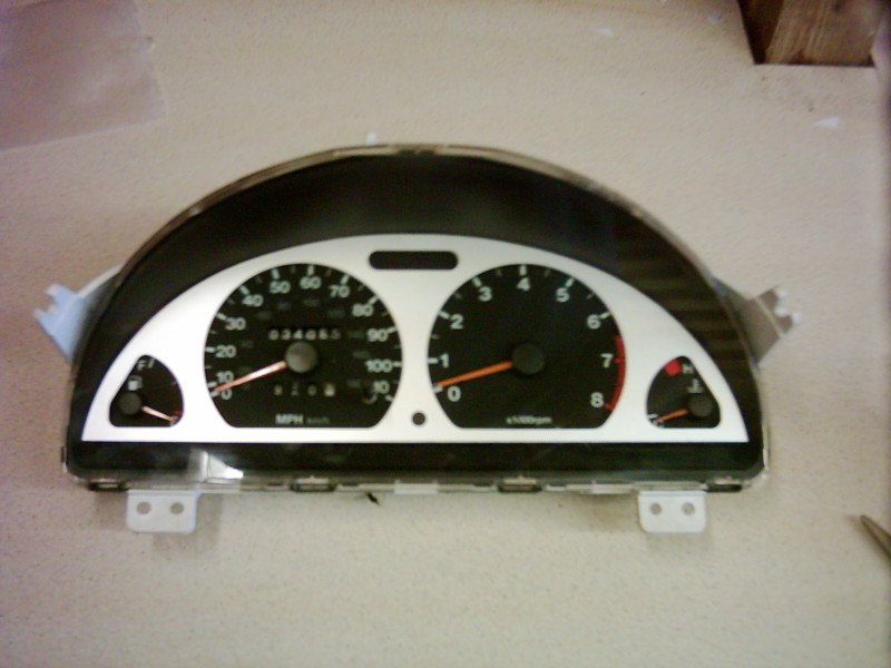

It never occured to me not to pull the steering wheel off mine when I modded the clocks. It makes it much easier to get at stuff. I'm guessing that you have an airbag fitted? Otherwise I think that your 96 will be the same as my 2000. I'm sure that there are 4 screws holding the cluster in place. I have pics somewhere I'll try and remember to post them.
Re: speedometer
« Reply #19 on: October 24, 2008, 09:47:32 AM »
This is my cluster, you can see the lugs for the 4 retaining screws. The bottom lugs also have holes for locating studs.
I found that I needed to disconnect the cable from the tcase first and then pull it through the bulkhead a few inches so that I could get my hand around the speedo cable.

thanks for the pic
