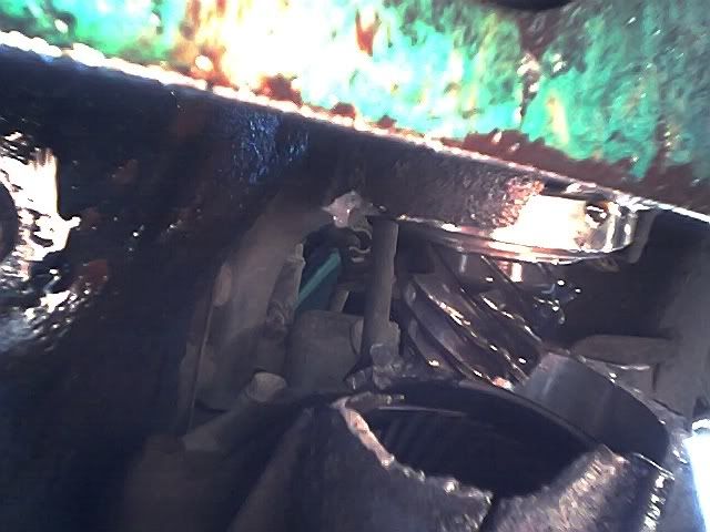

Whats so bad about the front housing?  I see alot of post about them being weak and I also see the 26 spline CV uprgrade.  But I never seen pics of them broke or how they break.  Just that it broke.  The front 3rd will break before the CVs let go?  Any pics of a broken one?  The torque just twist them and break the mounts?

this is from a little wheel hop and 31's, if i did a trackick again a steel third would be first on my list
