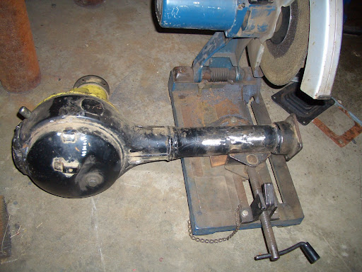

Wanting a steel front housing to put a locker in, and having a empty Sammi rear housing just setting there, my brain just said you can do that.  So I have started to convert a sammi rear end to a front end for my tracker.  The short side even has the same size bearing housing as the seal, so just shorten it up a little.
I took the angle grinder with 1/16" cutting wheel and got started.
Then I cut the flange off the end of the tube (cutting back far enough that there was just room for the seal).  Next I cut the rest of the tube off, leaving 3/16 of the inner tube (as the stop for the seal), welded these two together.
I installed a diff. into the housing, put an old seal in the new end and put it on a short side cv.  Sliding the cv and new end into the housing, I tacked the new end into place.
I cut a hole in a piece of 3/16" plate, slipped it over the new end, tacked it up and trimmed the edges back to conform with the housing and welded it up.  I Installed the seal again and test fit appears good.
This is what the short end looks like.

Got a good start today, until I ran out of wire.
First thing I did today, was cut off the bearing housing at the weld.  Then I tapped out the short section of axle housing, and cleaned up bearing housing.  The tracker bearing fits into the housing very snug, just like it should.  I will need to get a special seal, because the bearing housing steps up larger after the bearing (at least one seal, and the bearing will be stock).
After removing all the brackets on housing, and cleaning up the weld area, I cut the long side to appropriate length.  I then installed the bearing into bearing housing, and put bearing housing back on diff housing, and installed the axle.  Fit on this looking good.
After tacking bearing housing in place I removed the axle.  Bearing comes out with the axle, as I did not try to make a snap ring notch to hold it in.  As I stated before, I will have to get a seal sized to fit hole.  Just finished welding the bearing housing up, and ran out of wire.  So here is where it sits.
It looks bigger, and longer than the aluminum case.  But, the axles go all the way into the diff., so couldn't make any shorter.  I will measure the length from axle to axle on my running tracker (when it stops raining).
Tomorrow make and install mounting brackets.
