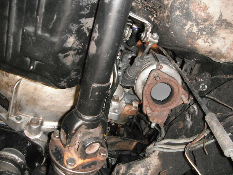

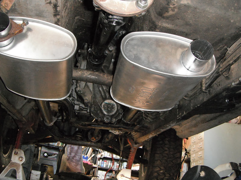

There appears to be little room for a crossover pipe for the exhaust.

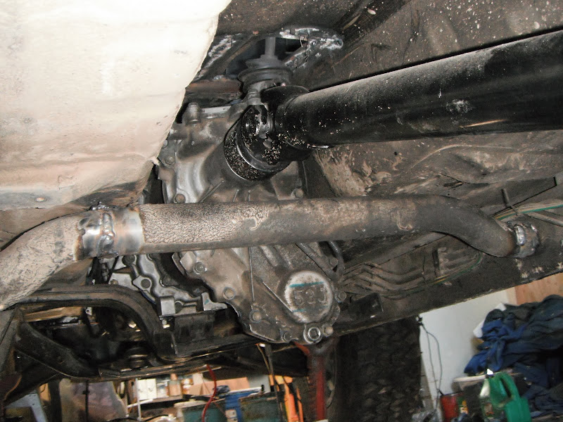

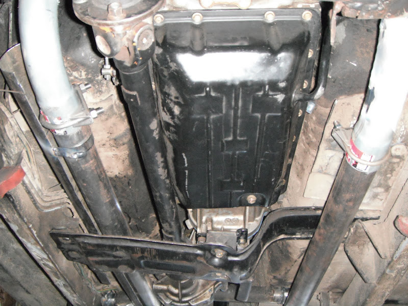

And the back frame crossmember had a hump in for the exhaust system on the drivers side, so I cut it in the middle of the hump and on the passenger side.  I turned it around and over, so now I have one large hump.
Big enough for duel exhaust.

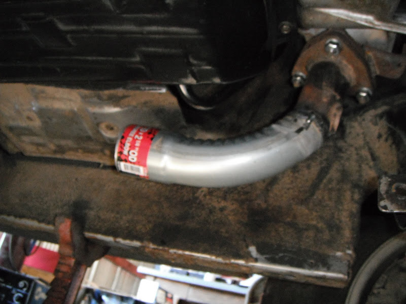

I used cut down 90 degree bends and welded them to the old crossover pipe stubs, leaving the 02 ports.

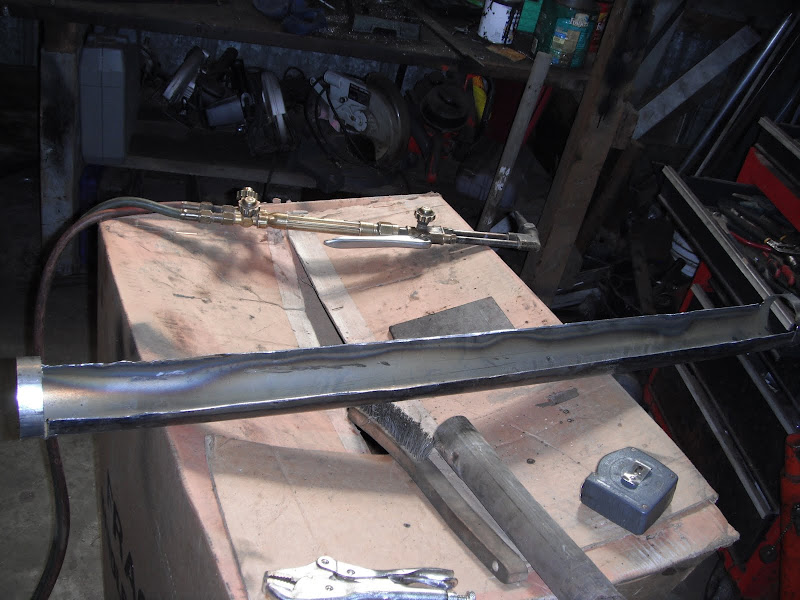

As the fuel lines and brake lines would be running right next to the exhaust pipe, I took a section of 3" exhaust pipe, cut some rings off of it, cut it in half and slipped on the 2 1/4" exhaust I am using.  I welded the rings up against one side of the exhaust pipe to create about 1/2 - 3/4 gap for the heat shield.
I put two mufflers on it and.
Little louder than I expected, does have a rasp to it when cranked up.
It is a good thing the drive line does not move sideways.  Could have used smaller mufflers, but could not find any.

We installed the bottom two 02 sensors, and it has a much better/quieter sound.  Still need to make up the tail pipes, but standing behind it you can hear that it has dual exhaust.

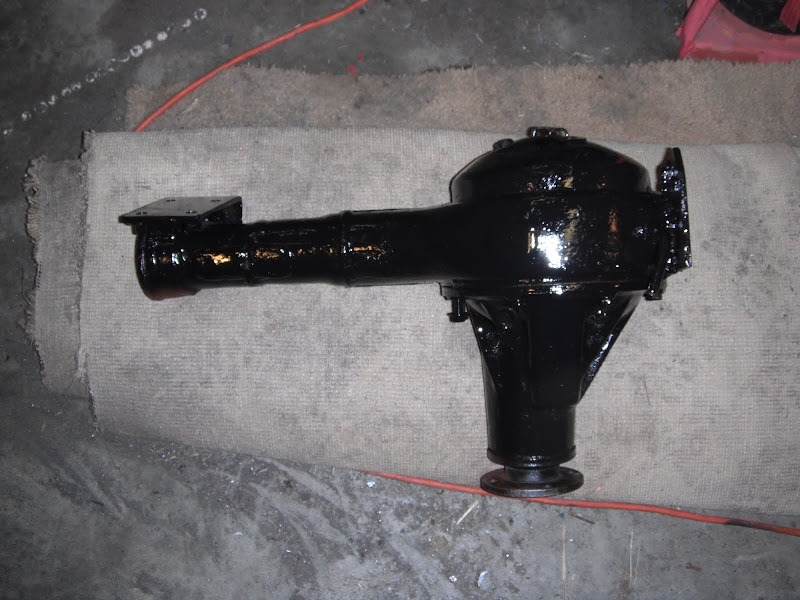

Front diff was setting to close to oil pan, so made new mounts to relocate with more clearance.  NAPA provided wrong seal so will have to wait for morning to install.

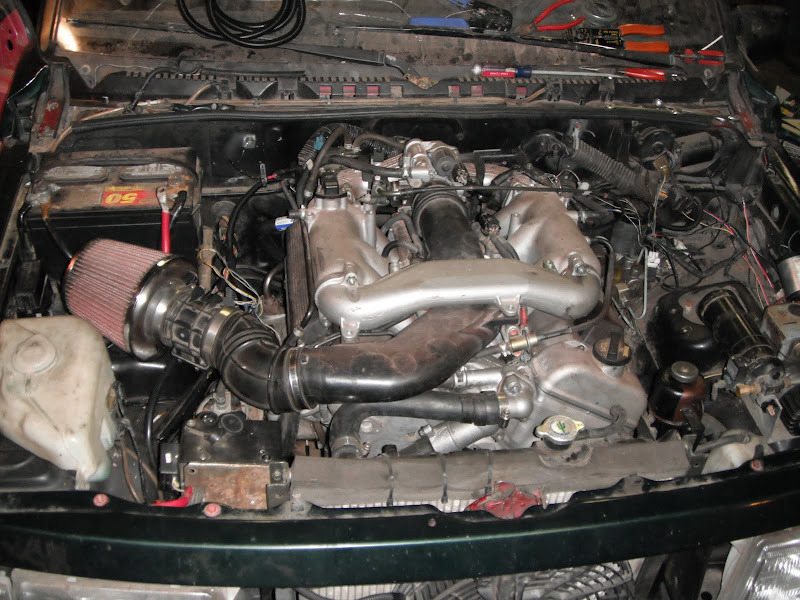

Motor compartment is getting full, most everything is in there.

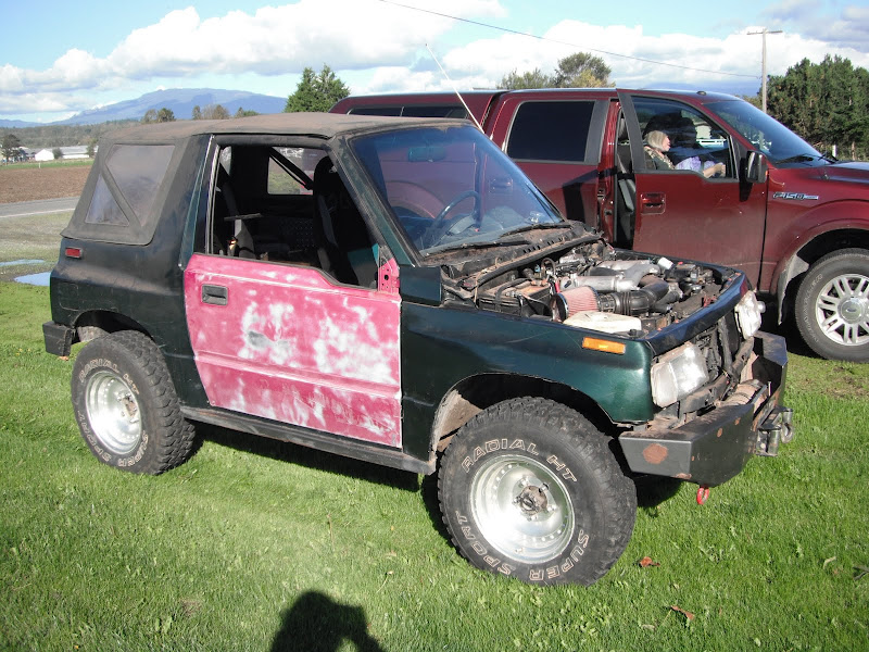

Front diff installed.  Drivers seat installed.  (You know where this is going.)
Awesome.  It is not a rocket on take off, but has no problem rising to 75 mph.  Speedo is off + 5 mph at 60.  This is so much fun NOW.  Now for the catch items, but it does run on the road.  Forgot to hook up the air line to front diff, so field tests on another day.  Not going to give it a roll test like the Trouble Race car.

you never stop working on that rig.  :laugh: pretty soon there wont be anymore modifying to do to it. It still looks good too.
87 Sami tin top
91 4 door SOLD
93 4 door
95 4 door
95 Geo 2dr V6
keep them coming
Have to do something about the pink door though.  :D
Offline jawman
  • 406
  • 1234
Yah, what happened? It is all dirty and I think I see some rust on that bumper. :laugh:

Yes, the Pink door, rust on bumper, and all the dirt are on catch items.
The low range TC gears were not engaging.  Seems that the TC adaption that I had made only seemed to work, teeth almost engaged and would not hold with power on them.  So I got another XL7 TC (2002), and the input/output shafts were smaller diameter.  Changing the input shaft (and case) was not much of an item, but getting both output shafts w/ connecting chain (which was also wider) took a couple of tries to get them started (and installed) straight.  Then installing the back case, and shift mechanism, it is ALMOST done.  The seals looked really beat, so I removed them so I could replace them.  Try finding output shaft seals for a 2005 XL7, most auto parts stores books only go to 2004 on the XL7.  I know the middle case (forward shaft) seal is the same for tracker's/GV's/XL7's, but the back case output shaft seal is larger.  I now have Suzuki part numbers, and will check with local Suzuki dealer Monday (online part stores do not recognize the numbers).
