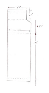

After the last trail run bumping over rocks & stumps I knew I needed a skid pan.  Checking dimensions, I found that I had a piece of stainless that was close enough, so my skid pan is started.

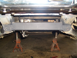

I welded a cross brace at the front A arms.
The piece of SS was 17.5" X 70" so my plan was have it cut to at 64.5" and both long sides bent up 90 degrees 1 3/8".  Then have small bends across the pan at 2" (down),  6.5" (up), 17" (up), 36" (up), the sides were cut to allow the bends.  I also made a wire jig so the bender knew about what I was looking for.

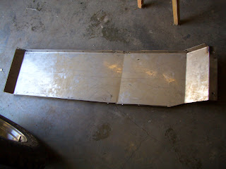

The metal came back close to what I needed.

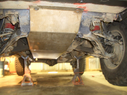

Then I started fitting under the Tracker to see where to notch for the cross members.

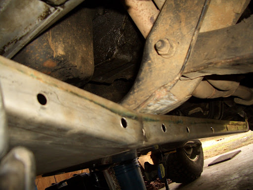

I had holes punched about where I thought they were need (on the sides so bolts would not get ground off) and then built brackets to hang the skid pan with.  I am hanging it off my bumper with two bolts, the two bolts at back of A arms cross member, and two bolts at the transfer case member.  I welded the nuts on the brackets so it would be easier installing removing.
Fitting, welding, grinding, (cutting off the bracket in wrong place) took longer then I figured, so hope to finish up tomorrow.
Replaced the bracket, enlarged some holes and bolted skid pan in place.
Test at Walker Valley on Sunday.

It shouldn't be too hard for him to clean.  There is only 8 bolts holding the entire pan on and all except the front two come in from the side of the skid pan instead of the bottom so they should avoid rock rash.

Looks great!  How heavy is it?  What gauge of SS is it?
1/8".  It is a little lighter than I would have used, but it was just standing in back of garage and I needed a skid pan.  I'll see how it holds up.  The distance between cross braces is not that long, and I am not doing really radical rock.

I was considering the cleaning issue when I was installing/removing, putting in brackets, etc., and hoping that I don't have to remove or drop down to clean out often.  I will probably have to enlarge the mount holes after trail damage to keep fit easy on/off.  The exhaust side is open, but may encounter engine heat being trapped.  But hey, Fall is here and a little heat won't be bad for awhile.  I'll let you know how it holds up the first trip.
