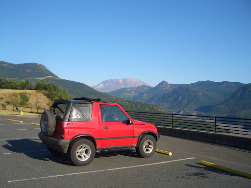

Thanks for everyone's help and Bashum for giving me the flares at Elbe.  I ended up with the 3" JC Witney flares, and a rivet about every 4 inches.  The rivets had a 1/2" head on them, and I used 1/8" - 1/4" aluminum rivets.
With two people it took about 20 minutes per flare.
We marked the entire flare at every 4" with a pen.  Once you line up and tap the front hole, you have one person hold the fender in, and the second just drills in next to the edge, then taps in the rivet and then use the rivet gun to lock it in place.  Then you move onto the next rivet spot.  Once you get into a rythem you can just zip right through.
While we were back there, I pounded the inner lip on the inside of the fender flat to get rid of some rubbing.  I really should take pictures as we are doing things like this, but you get on a roll and just forget.  ;D
Anyway, here are some finished shots on a Tracker with 1.5" wheel spacers.  Next up is some 1" rear coil spacers and GV Front springs.
