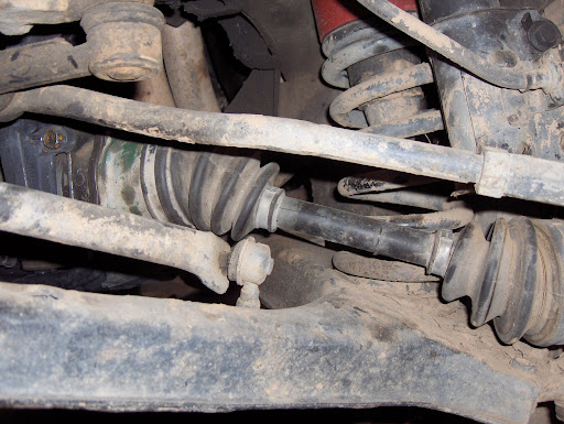

After blowing a CV during the first hour at Walker Valley I decided to lower my front diff., to reduce the CV angles.
Here is my CV at rest (before).
And here it is fully extended (before).

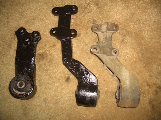

I cut the diff. hangers and added 2" spacers (which was to much, so they are now are at 1 1/2"), and replaced the cross member to get clearance for back of diff.
Here is the rebuilt diff. hangers, with a stock drivers side for reference.

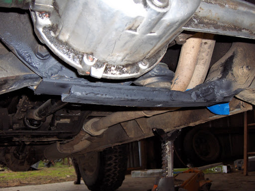

And here is what the cross member now looks like.
I have about 1/4 clearance on bottom of diff. snout.  I welded a heavy washers on to the bottom both sides of back diff. mount.
I achieved much better CV angles as show at full extension.
I tested for clearance/binding of the CV's due to having moved the diff. lower.  No problem with the CV shafts straight, they still have clearance at the flanges.
